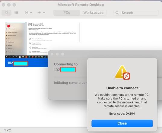

  - Regardless of how you are connecting to your Windows 11 device, the following steps below will help in resolving the issue.
  - Below is the error that was prompted when I tried to remotely connect to my Windows 11 device “Unable to connect - We couldn‘t connect to the remote PC. Make sure the PC is turned on and connected to the network, and that remote access is enabled. Error code: 0x204”...

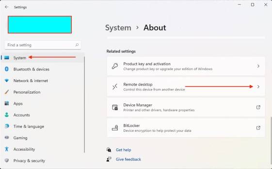

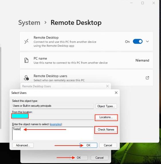

  – 启动 Windows 设置和
  – 单击系统
  – 单击远程桌面,如下所示

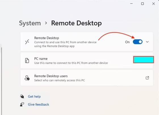

  验证并确保远程桌面连接已打开,如下所示。

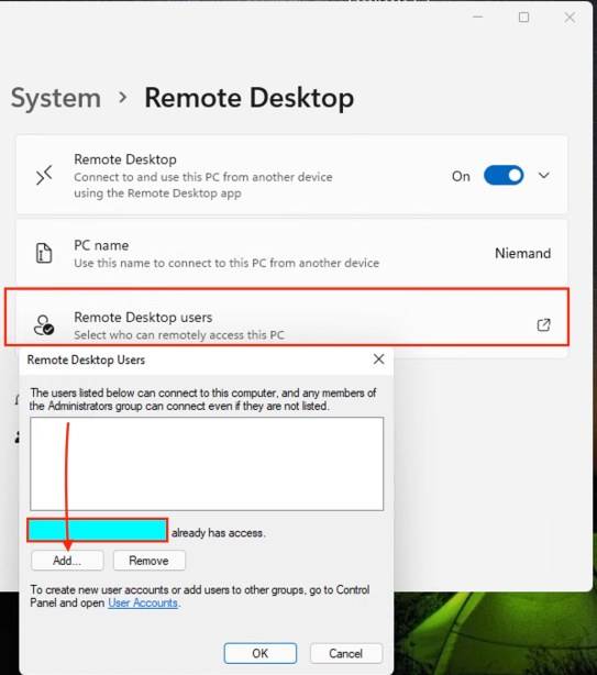

  您可能还想通过远程桌面连接允许(授予)选定用户访问此工作站的权限。为此,请单击远程桌面用户,如下所示,然后单击添加
  将出现选择用户对话窗口。输入用户名并单击“检查名称”,如下所示
  – 找到后,单击“确定”并再次单击“确定”以关闭所有对话窗口。

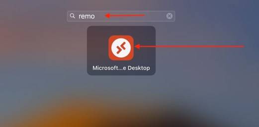

  单击您的 Launchpad 并再次启动远程桌面连接,如下所示

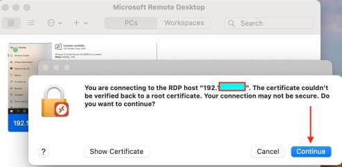

  正如您在下面看到的,我能够再次连接到设备。单击继续以继续。
  如下所示,远程桌面连接问题已解决。
